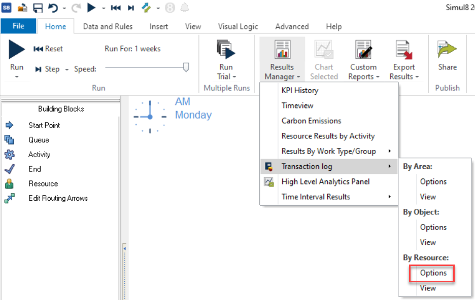

The Resource Log is accessed through the Results Manager drop-down button on the Home tab.
Setting Up the Transaction Log by Resource
Go to Home > Results Manager > Transaction Log > By Resource> Options.
Simul8 Log by Resource tab

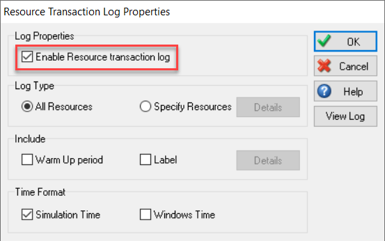

Make sure that the “Enable Resource transaction log” box is checked.
Simul8 Resource Transaction Log Properties
Log Type
Choose whether you want to generate a log for all Resources in your simulation or Specify Resources and click on the Details button to select which Resources you want to include in the Transaction Log.
Include
If your simulation uses a Warm Up Period, you can include it in the Transaction Log. You can also include Labels – click on the Details tab to select which Label should be included.
Time Format
Choose between displaying the Transaction Log based on Simulation Time, the current time format of your device (Windows time), or both. If you choose Windows time on Simul8 Online, the US date format will be used (MM/DD/YYYY).

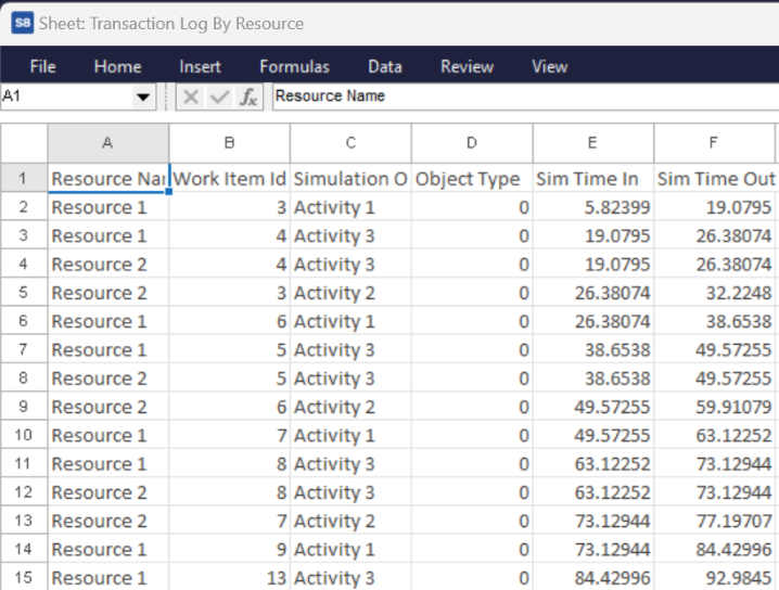

The Transaction Log will by Resource details the work carried out by the Resource(s) in chronological order of Time Out, and it should look like this:
Simul8 Transaction Log By Resource SpreadSheet
The Resource Log contains the Resource Name, Work Item ID, Simulation Object, Object Type, Time In, and Time Out and any Label values you have chosen to include. If you chose to run a Trial, an additional column referencing the Trial Run Number will also be included.
At the end of the log you will find a series of entries which only show Time In – these cover all items that remain within Simulation Objects at the end of the run.
Please note: In the Transaction Log By Resource, Object Type will always be 0 because the Resource is in use at an Activity.
