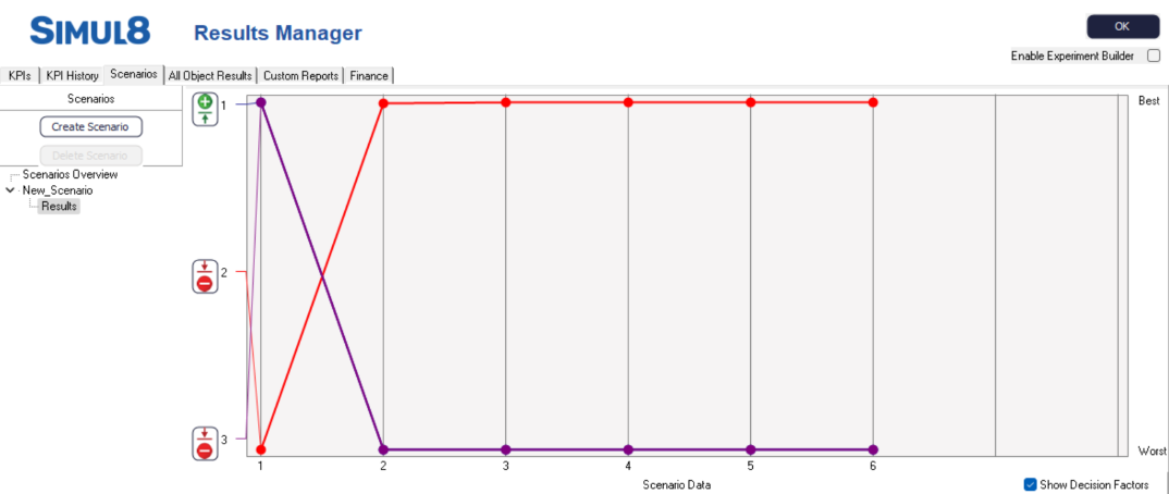

Once the scenario has been run, you can view the KPI comparison for each run in line chart format. From the scenario's Results, select the Show/Hide Line Chart icon from the right hand side of the window.
This line chart maps out the KPIs for each run. You can adjust the orientation of each KPI (ie, changing the charting to display Best to Worst or Worst to Best) by selecting either the Red Minus or Green Plus button to the left side of the chart.
