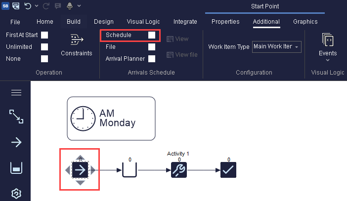

This data is also stored in an internal Simul8 spreadsheet, giving you flexibility to control it through Visual Logic at run time if needed. To access the Start Point Schedule, go to the Start Point the navigate to the Additional tab, and activate the Schedule checkbox.
Simul8 Start Point Schedule
The dialog below will open.

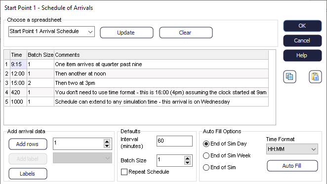

It initially opens with an example of the syntax you can use to create your Schedule.
The Schedule table includes the following columns:
  • Column one contains the time that the Work Items will arrive.
  • Column two contains the Batch size, i.e. the number of Work Items that will arrive at the given time. Note that if you want to use the normal Batching value as specified in the Start Point, enter a value of -1 in the Batch Size column.
  • Column three contains comments of different arrivals to be used as a memo.
  • Additional columns are created after clicking on “Labels”. This allows you to select a Label and define the Label value of each item in the batch coming in.
You only need to input the times when Work Items are entering the simulation, taking a new row for each new batch of arrivals. Alternatively, if all Arrivals happen at once, create a single line, and set the batch size to be the volume of arrivals. This might be useful if you have a weekly delivery for instance. Arrivals can also occur at Simulation Time 0.

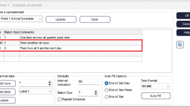

To set the arrival for the next day simply add a line with a lower time value than the previous one. For example, this could be setting an arrival for 09:00am after a row with an arrival time set to 12:00 as in the image below.
