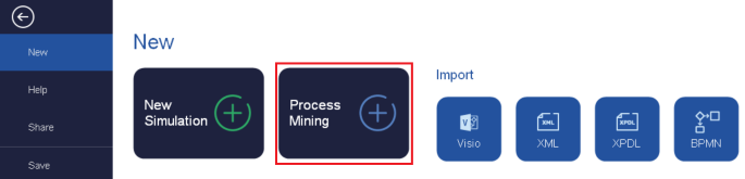

When you open Simul8, select the option to Create New Process Mined Simulation.

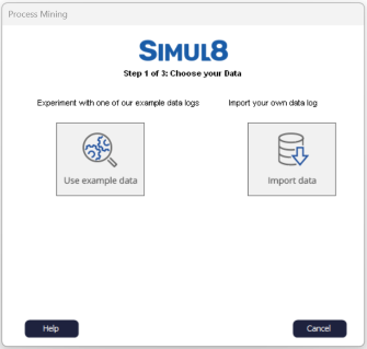

Next, you will be given the choice of whether to run one of Simul8’s included pre-populated example data sets or to import your own data set.

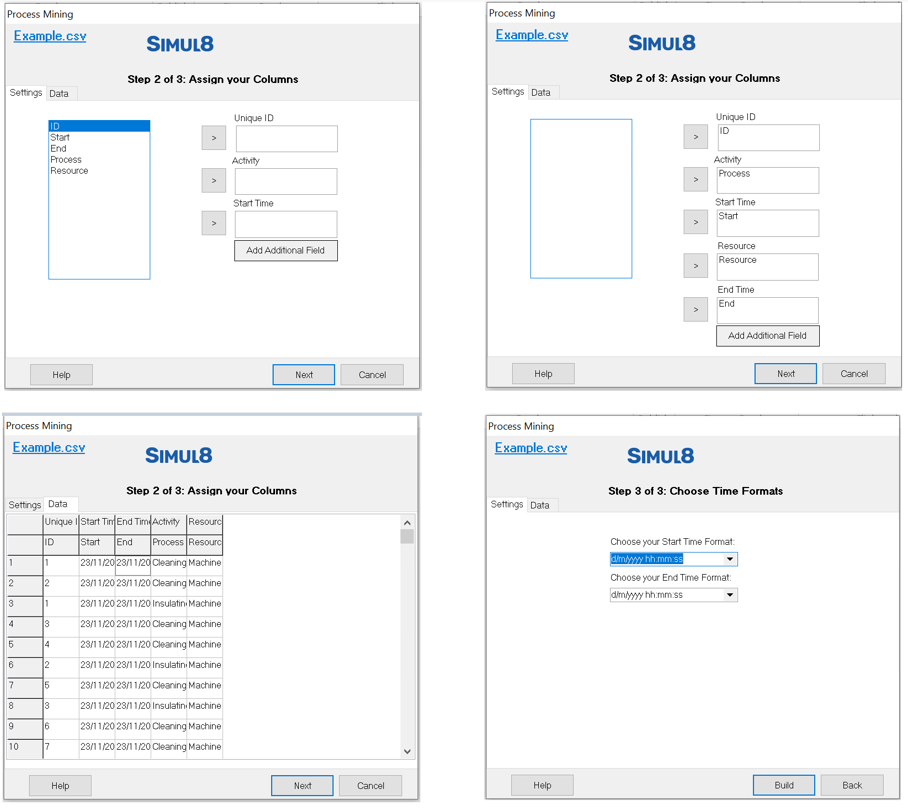

Once you have selected your data set, you will need to define your columns and date/time format. As a minimum, the Unique ID, Activity, and Start Time columns will need to be assigned.
Step 4
Hit build, start simulating and gaining insight! You will see that a clear structure with a detailed Arrival Schedule is automatically generated.
