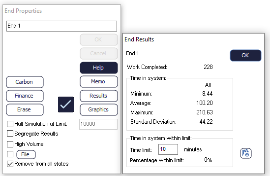

For example, build a small simulation with a Start Point, a Queue, an Activity, and an End Point, and run the simulation for the default week. Double click on the End Point to open up its properties dialog and then on the Results button as shown below.
End Point Results
Among other things, this will show you how long the items of work that were processed in your simulation took to get through the system (on average).

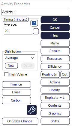

Double click on the Activity to open its properties.
You will now see a dialog box that gives you access to an enormous number of parameters and settings that can be used to configure how work is done.
For now, just change the number in the box Labeled “Average” from 10.00 to 20.00.
Activity Properties
Click the OK button to go back to the main simulation screen and then click the RUN button.
Once the simulation has run, take another look at the Results inside the End Point Object.
