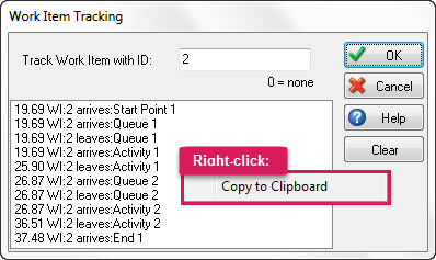

Work Item Tracking - Results
Right-click on the results to copy them to your clipboard.
The log provides a step-by-step account of the history of the Work Item, providing the simulation time as well as the location of each event the Work Item took in the simulation.
