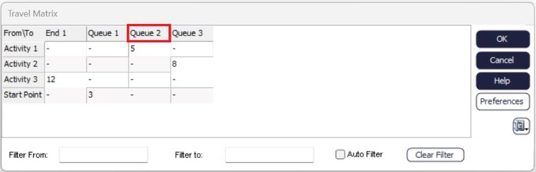

Select the From\To cell to display all connections. In the screenshot below, the From\To cell was selected, and all objects are shown.
Select an object from the From(Vertical) axis to filter all connections that are made from that object.
In the below screenshot, Activity 1 was clicked on the vertical axis. Note that by doing so, Queue 1 has been removed from the horizontal axis, as there is no connection between Activity 1 and Queue 1, so it has been filtered out.
Select an object from the To(Horitzontal) axis to filter all connections made to that object.
In the below screenshot, Queue 2 was clicked on the horizontal axis. Note that it has filtered out all objects that do not feed into it, therefore only displaying Activity 1 and Activity 3 which have connections to it.
