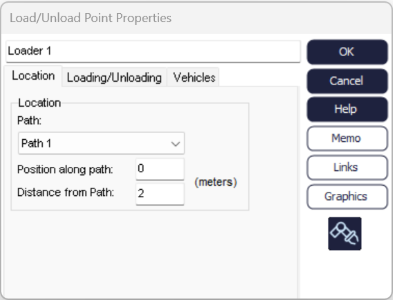

Create a Loader from the Advanced Building Blocks tab on the Simulation Drawing Tool Panel. Enter a Loader's dialog by double clicking on the Loader.
The location tab shows the path the Loader is located next to and the exact position (in feet or meters) from the start of the path. Selecting the path defines the path network because each path is in only one path network.
