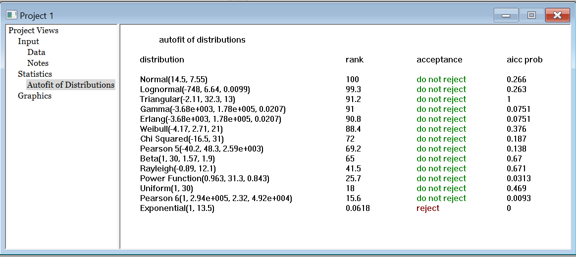

  • Click AUTOFIT on the toolbar and select UNBOUNDED in the second box then click OK
  • You should now see acceptable distributions
Simul8 STAT::FIT results
  • In this case let's choose a Normal Distribution because it has been ranked the highest but if something like a Lognormal distribution was more appropriate, there is not enough evidence from this small dataset to suggest this is wrong, so we could equally choose this

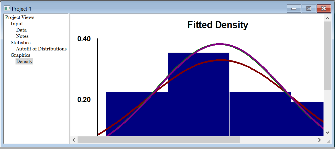

  • By clicking the Graph Fit button we can also see what any of my possible distributions look like compared to the data
Simul8 STAT::FIT graph
Since we have chosen a normal distribution we just enter this into the Start Point in Simul8 with the parameters shown of Average 14.7 and standard deviation of 7.55.
