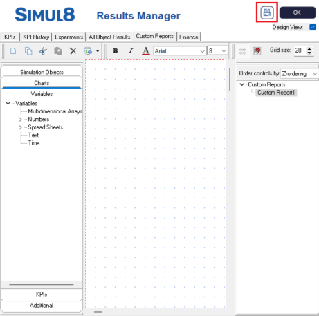

Exporting Custom Reports as a PDF
First, navigate to Custom Reports by going to the home and selecting the Results Manager. Select the Custom Reports Tab from the top of the Results Manager window.
Now, to save your Custom Report as a PDF:
1. Select the Print icon in the top right of the Custom Reports Window
2. In the Print Preview dialog, select More Options »
3. This will expand the dialog. Now select Save as PDF to save your Custom Report.
