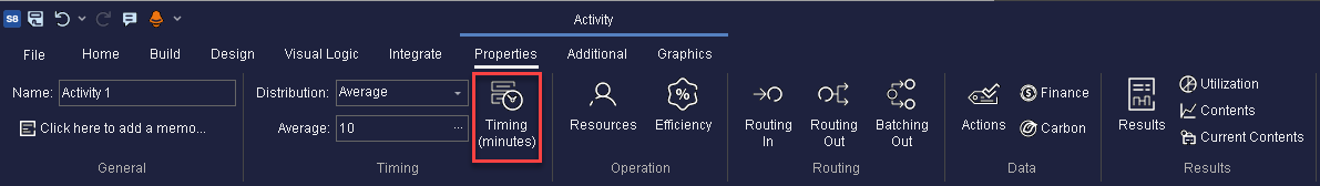

Simul8 Activity Timing Ribbon Dialog

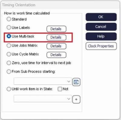

To set an Activity's process time to multi-task, start by selecting the Activity and chose Timing Orientation. From the Timing Orientation dialog select ‘Use Multi-task’ and click the Details button to view the Multi-task Timing dialog.
Timing Orientation Dialog

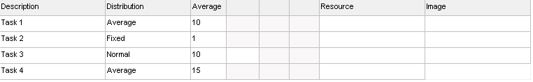

Multi-task Timing properties table
Each row in the properties table represents a task that will occur at the Activity, with tasks carried out in order from top to bottom row. Use the Add Row and Delete Row buttons to add or delete tasks from the table. The Add Row button will also copy the details of a selected row, making it quicker to copy any Activities with similar parameters.
Simul8 Multi task Timing Dialog
Multi-task Timing table columns
  • Description – enter the name/description of the task
  • Distribution – select the cell to view a drop-down list of available distributions and select one you want.
  • Distribution Parameters - the parameters of the distribution vary with the type of distribution selected. Columns are automatically greyed out if the parameters are not required and the column headers will update based on the selected distribution. The column headers will also update based on the selected task. You can also double-click each parameter cell to open up the formula editor.
  • Resource – Double-click this cell to see a list of all available Resources in your simulation and select the Resource you would like to assign to a task. Multi-task Timing uses default Resource behaviour e.g. it will assume 1 Resource is required before that task can start and will be released as soon as the task has completed.
  • Image – Double-click this cell to show a list of all images available in your simulation. Simul8 will use the selected image when this task is active.
